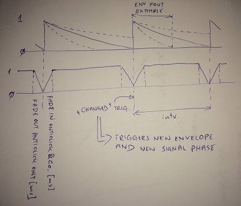

...Let's start from scratch...
Sorry for confusions.
p.s.: I'm not sure how the phase change point truly relates to "changed" trig. Maybe that's the issue?

Re: How to eliminate 'click' problem?
Yes, this is almost what my schematic does. Only problem is, that you need lookahead to "de-click" the decay envelope by fade out. In my schematic this is done by delaying the trigger/pulse that starts new envelope and re-triggers phase and uses the original (non-delayed) pulse to trigger the fade-out.
As long as you will keep the same delay (=fadeout length) on all oscillators, their phase relationship will remain the same.
The Fade-in part is done by an envelope follower (lowpass filter) on the original envelope. This sort of adds "attack" to the envelope (effectively creating AD - attack-decay envelope). You can see this in my schematic by pausing the scope just in right time to see the envelope transitions.
