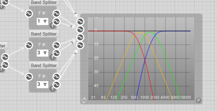

Multi-Band Splitter Tutorial
Posted: Thu Oct 09, 2014 10:01 pm
Okay, here is my multi-band splitter tutorial. Please give me your feedback so I can improve it and put it up on FS Guru. ;)
Re: make a 7 band eq or better splitter
Posted: Thu Oct 09, 2014 10:31 pm
by KG_is_back
wow martin this is great! ...maybe adding phase/magnitude switch to the analyzer?
