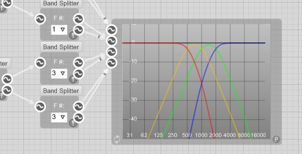

Multi-Band Splitter Tutorial
Okay, here is my multi-band splitter tutorial. Please give me your feedback so I can improve it and put it up on FS Guru. ;)
MultiBandSplitterTutorial.fsm
(88.24 KiB) Downloaded 1207 times

wow martin this is great! ...maybe adding phase/magnitude switch to the analyzer?
