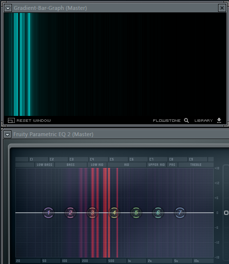

Wow KG, this thing is pretty. I changed the multiplier value going into the bar graph module to 0.05 for better visibility. I did notice the scaling seems a bit odd though.
FFT Scale.PNG (189 KiB) Viewed 20661 times
Even with the log scaling, the higher frequencies get a lot more space. Tried screwing with the math here but apparently don't know what I'm doing. Maybe it's a log base other than 10 on the PEQ2 meter?

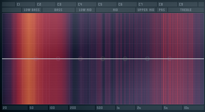

Hey look at me! I added alpha all by myself! :lol:
It's only for the background (min) color though (the "max" color is doing something else I'm not sure of with the alpha). Still useful. I mean that was the more important part. I blopped a background image in there just for demonstration.
Edit: Figured out how to set/scale the bar (max) alpha, but it's pointless here since it's just drawn on top of the background color with alpha in the first place. You can just scale the input values and it would do the same thing.
