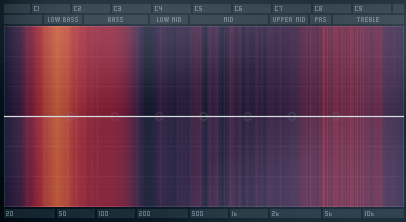

Not sure what will come of this but I'm just going to open the discussion.
Something approximately along the lines of this:
PEQ2 Spectrum.PNG (139.72 KiB) Viewed 20703 times
Would be wonderful to have in FS. I find it to be FAR more readable than the typical line-graph style FFT for most practical applications.
I've searched and could only dig up one example of this in the forums (including SM forums), here:
viewtopic.php?f=2&t=2446&hilit=fft
While that schematic appears functional, it devours CPU and drags down the draw rate, and only more so if you increase the window size.
Do you think something like this that's efficient enough and fairly accurate is feasible in FS? It's kind of frustrating that the line-graph style FFT is so easy to piece together in FS yet just drawing vertical lines from an FFT array is so much more complicated. :?

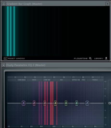

Wow KG, this thing is pretty. I changed the multiplier value going into the bar graph module to 0.05 for better visibility. I did notice the scaling seems a bit odd though.
FFT Scale.PNG (189 KiB) Viewed 20650 times
Even with the log scaling, the higher frequencies get a lot more space. Tried screwing with the math here but apparently don't know what I'm doing. Maybe it's a log base other than 10 on the PEQ2 meter?

And just for fun...
