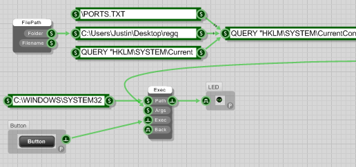

How do i use ShellExecute on console applications?
This is what i have, won't function in fs :(
regQ.fsm
(26.34 KiB) Downloaded 947 times
Re: ShellExecute Commandline
Posted: Tue Jul 29, 2014 6:03 pm
by JB_AU
Solved: For future Reference
Path: cmd.exe (no path needed, part of OS)
Argument: /c reg.exe argument1 argument2 (/c command, & again no path needed)
