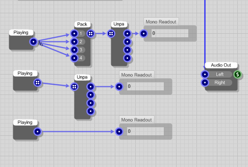

In the meantime, here's a way of working around it that might help...
I'm testing in FL....
Nothing works in this pic....
Then, for some reason, just drop this into schematic..
And everything works.... :? :?
give it a try with your fsm...weird... :?

thanks billy, i know, normally i use the green version but i need the blue one in my actual case..
i reported this to the support.
Re: 'is playing' stream primitive doesn't work
Posted: Thu Jul 17, 2014 9:58 pm
by billv
I didnt clarify this...but dont connect the green/ruby
prim...just drop it into schematic un-connected..
and still use the blue.
