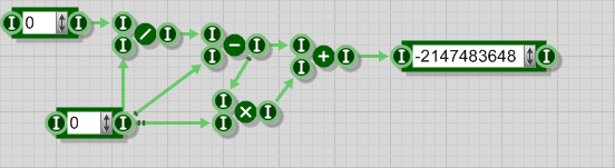

This makes no sense as the answer should be 1 , any whole number divisible by itself is 1 even 0, 0/0=1 or 1x0=0 ?
- capture.png (18.43 KiB) Viewed 18129 times

0/0= value undefined (it can be anything you what).
Here how computer thinks on this:
in floats x/0 is very very big - actually bigger than any number that can be written as float. Floats have a special value for that and that is infinity.
Integers don't.
There are two conventions on integers - unsigned and signed. in unsigned 32bit integers minimal value is 0 (all bits zero) and maximal value is 2^32-1 = 4,294,967,295 (which means all bits are one).
Unsigned are different. The scale is divided into two halfs. numbers from 0 to 2^31-1=2,147,483,647 are the same as unsigned. But there the things wrap around. what would be 2,147,483,648 in unsigned is -2,147,483,648 in signed. next number is one larger -2,147,483,647 and so on. What was unsigned maximal value (4,294,967,295) actually happens to be -1 in signed (all bits one).
What is remarkable, actual addition and subtraction on both signed and unsigned integers are the same (only you get different number displayed on screen after you convert the binary structure to decimal). You can actually check this very easily in flowstone. Simply add 1 and 2,147,483,647 and you'll get -2,147,483,648... That is called overflow and it is a fault of the logical circuits that preform the operation (they can however detect this event).
Flowstone uses signed integers only. So how computer thinks of x/0 in signed integers?
well the result is bigger than any number that can be represented as signed integer. What is that number? Well computer adds 1 to the maximal number, and that happens to be -2,147,483,648. and overflow happens.
Integers don't.

Well it seems so - But 0 / 0 is never 1
Every other nuber dividet by itself this would be true - but never in case of 0 because it could be everything
see here: http://en.wikipedia.org/wiki/Division_b ... iplication
still a little confusing that flowstone still gets an result
- in Ruby it is correct
Regards

That is probably because Ruby checks overflow flag after computations and flowstone doesn't. So Ruby simply writes you that the result is complete nonsense where flowstone writes you the compete nonsense as if it was OK.

KG_is_back wrote:That is probably because Ruby checks overflow flag after computations and flowstone doesn't.
Yup, exactly right. For floats, the behaviour is written into the IEEE standards, which are honoured at the CPU level on almost all mainstream chips. So calculations with floats are generally pretty reliable - you'll get the appropriate NaNs (Not a Number) and infinities. For integers, things are less well defined, so checking the flags become necessary - but 'green' has no concept of errors/exceptions, so it has to fail 'silently' (i.e. not fail at all!).
