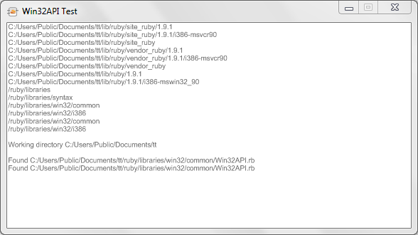

Re: Win32API bug
Win 7 no 'require SUCCESS' message
sorry
sorry

Re: Win32API bug
Wow, that was fast!
Many thanks, this is exactly what Malc needs to know so that he can get to the source of the bug - I'll pass that info onto him straight away.
No need to apologise - it's not your fault that Flowstone has a bug!
Xtinct wrote:sorry

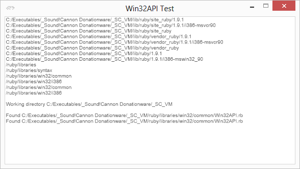

Re: Win32API bug
Hi Trog!
My System:
Win8 64 bit Quad Core
with Admin rights
cheers,
Walter
My System:
with Admin rights
cheers,
Walter

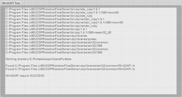

- win32API Test_in FS.png (53.92 KiB) Viewed 18452 times
- Win32API Test.png (28.92 KiB) Viewed 18452 times

Re: Win32API bug
Brilliant - thanks Walter.
That pretty much wraps it up then - definitely something in Flowstone.
Looking at the reports, I also notice something else...
The User guide states that you must copy the 'ruby' folder OR have FS installed on the machine. However, no-ones $LOAD_PATH includes the 'win32/common' folder from Program Files - just a duplicate of the working directory relative path. This is why I explicitly asked for folks to copy the folder - were the user guide and $LOAD_PATH correct, this shouldn't be necessary for any of us. Seems that this is "universal" to all installations as well.
Time to mail Malc again!
