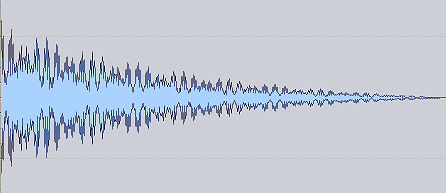

I have a problem to solve. If I have a beating sound, made of 2-4 FFT (sine like) components (= slightly irregular envelope, beating speeds unknown) that fades out (not linearly) - I'd like to draw (measure) a curve that follows peak (or average? or peak?) values of that fade out.
Sometimes the beating sound may be made of 2 FFT components, producing 0.2Hz beating. So - how to approach it, to get theoretical curve points in selected points of time? Some sort of envelope follower? Some sort of FFT band recalculation at some sort of resolution?
Martin? KG?
Martin? KG?
- curve.png (21.71 KiB) Viewed 18356 times

The easiest would be to take an envelope follower with a decay time long enough to average out the beating but short enough to follow the fade-out of the sound. (In your graph the beating appears to be much quicker than the fade-out.)

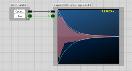

You might try to model your signal as exponentially decaying and fit the time constant. Here is a schematic that may serve as a start. I adopted KG's idea of analyzing the wave file in reverse order, searching for peaks which are greater than previous peaks. The resulting set of data points is used for a linear regression to determine the best exponential envelope fit. Hope it helps.
- DecayFit.fsm
- (1.39 MiB) Downloaded 972 times
- DecayFit.png (24.99 KiB) Viewed 18225 times

Thanks, I will play with it.
These are kind of sounds I deal with (see attachement). Sometimes band1 is most audible, but not always, so this is just an example. What usually happens - is the change in decay per band, and this is more interesting.
Theoretically, decay is indeed some sort of exponential fade out, I just didn't know how to approach it due to multi-peak structure.
Anyway you are amazing.
