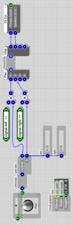

panner.fsm
(87.91 KiB) Downloaded 942 times
Cool.
Here is a pan knob, with a make-up pan law.
You could add it to the synth.
Plug the signal in where the ins are marked left and right with a string.
Cheers 8D

Thanks again Nix,
the last one is a bit hard for me but i study it....
