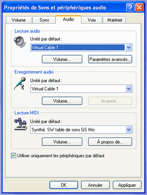

- open the Windows Sound Control Panel
- go in the "Audio" tab and select "Virtual Cable 1" for the Default Audio Play and "Virtual Cable 1" for the Default Audio Record
- go in the "Sounds" tab and select "no sounds" - this will ease Windows job (no more beeps to process and mix)

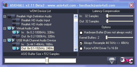

- ASIO4ALL should wake up, the ASIO4ALL icon should appear at the right bottom side of the screen - it's labelled "ASIO4ALL v2 - Flowstone"
- for configuring ASIO4ALL in advanced mode, click the ASIO4ALL icon in the tray, the ASIO4ALL configuration windows pops up, and for accessing the advanced settings you need to click the "tool" icon on the bottom right corner
- look the "+" symbol preceding each device in the WDM Device List : AMD High Definition Audio Device (that's the HDMI on the motherboard), Realtek High Definition Audio (those are the audio jacks on the motherboard), Virtual Audio Cable, and USB Multi-Channel Audio Device (this is the SWEEX SC016).
- only "Virtual Audio Cable" and "USB Multi-Channel Audio Device" must be active
- click the "+" in front of "Virtual Audio Cable" - over there, only the "In" should be active
- click the "+" in front of "USB Multi-Channel Audio Device" - over there, only the "Out" should be active
- go back to Flowstone, and make sure that the ASIO-in and the ASIO-out modules are activated - in the schematic, you may need to click on the "ASIO4ALL v2" labels for getting them blue instead of grey
- blue labels over there mean that Flowstone has properly detected the installation and the configuration parameters of the SWEEX SC016, VAC and ASIO4ALL
- regarding ASIO-in, make sure the ports are labelled "Virtual Cable 1.1" to "Virtual Cable 1.8" - actually we will only use Virtual Cable 1.1 port and Virtual Cable 1.2 port
- regarding ASIO-out, make sure the ports are labelled "Audio Device 1" to "Audio Device 8" - we will use them all for a stereo 4-channel crossover

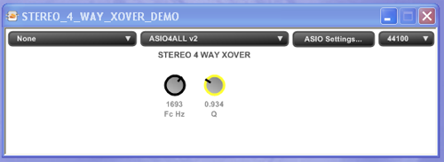

We launch the crossover .exe compiled by Flowstone.
The crossover GUI pops-up, as a small window. We can thus modify the settings at will.
When the GUI consists of more than a few potentiometers, the GUI size gets bigger, and the GUI window comes equipped with a minimize button.

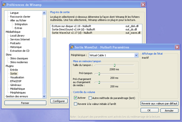

Befaure launching Winamp, the Winamp output plugin needs to be selected and configured.
One can rely on the WaveOut plugin.
Options - Preferences - Plugins - Output - WaveOut v2.17 (d) - Configure - Peripheral "Virtual Cable 1"
Options - Preferences - Plugins - Output - WaveOut v2.17 (d) - Configure - Peripheral "Default Player".
Both should work, as "Default" got defined as "Virtual Cable 1" in the Windows Sounds Control Panel.

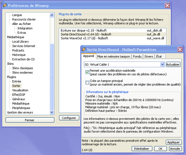

Another possibility is to rely on the DirectSound plugin instead of the WaveOut plugin.
Options - Preferences - Plugins - Output - DirectSound v2.64 (d) - Device tab - Select "Virtual Cable 1".
Options - Preferences - Plugins - Output - DirectSound v2.64 (d) - Device tab - Select "Default".
Need to validate the choice, and restart Winamp for the changes taking effect.

ASIO4ALL settings.
Those settings are not guaranteed to remain after a reboot.
Remember to verify them after each reboot.
- ASIO4ALL settings.png (22.56 KiB) Viewed 64848 times

WINAMP WaveOut v2.17 (d) settings.
This way the WINAMP WaveOut output plugin sends the stereo audio to Virtual Cable 1.
It should also works when specifying "Default", knowing that "Default" got defined as "Virtual Cable 1" in the Windows Sounds Control Panel.
- WINAMP settings (600).png (112.6 KiB) Viewed 64848 times

Kind of .fsm that you can ask Flowstone to compile as Standalone .EXE
For safety, the Audio is disabled upon loading the .fsm.
Before enabling Audio, please reduce the audio volume to a safe level.
In case you have mikes connected on ASIO-in, and you are not sure about VAC, please disconnect the mikes for avoiding any Larsen risk.
Only enable audio when you are sure no Larsen car happen.
See attached file.
See attached file.
- Stereo 4 Way Xover Demo (500).png (26.46 KiB) Viewed 64783 times
- STEREO_4_WAY_XOVER_DEMO.fsm
- (7.14 KiB) Downloaded 2316 times

WINAMP DirectSound v2.64 (d) settings.
The "Device" tab enables the WINAMP DirectSound output plugin to send the stereo audio to Virtual Cable 1.
The WINAMP volume potentiometer is working well, independently of the other audio sources. This was not the case when the WaveOut output plugin was selected.
- WINAMP settings (DirectSound) (600).png (197.63 KiB) Viewed 64845 times

Windows Sound Control Panel settings.
- Windows Sound Control Panel settings (300).png (60.64 KiB) Viewed 64836 times
