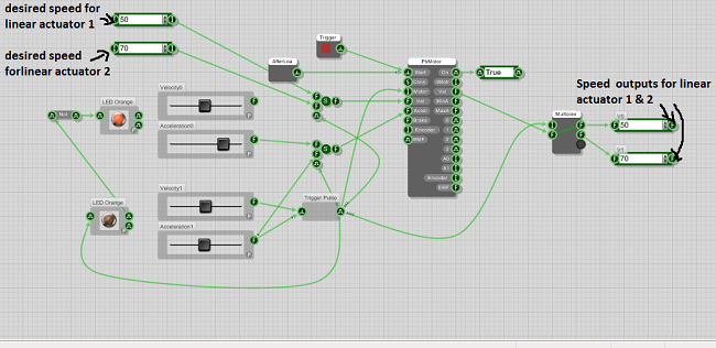

Hello, I am a student and I use flowbotics software for a project.
I want to drive two electric actuators with card "Phidget Motor Controller 1064" but I did not succeed. I can drive a single linear actuator at a time but not both together with the Phmotor unit. I used and tried flowstone example Phidget motor controller 1064 to control the two linear actuator but i didn't successful. I'm novice and i need help, thank you.

Please I need help, I added a picture to show the situation. I want to control the two actuators at the same time but with this module I can only control one by one.

hmm, maybe this would work for you?
i dont know how this phidgets module works, after you have just one vel and acc input and you need to tell the module which motor you want to control via the index you only can control one motor at the time, you can switch between the faders for each motor depending on which is moved last (look example)
just take care to select the index first and then send the values, right triggerorder is important here.
hope it helps
hope it helps

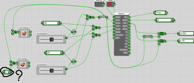

Thanks a lot for this answer. I tried to understand the mechanism and i don't know how to change motor selected.. I may have found the index to change motor but i didn't know how to use it. When i change values, only v0 changes not v1. I didn't need slider, just floats or int to select values. Sorry i'm not conffortable with this software flowbotics, i have used it for a week. Thanks

like you modified the schematic it only can control v0 because you send trigger signals to 'empty last primitive so both inputs of the last primitive which should set the motorindex are 0 so the index is always 0 you need to give values to the inputs of the last primitive
i included a little example how to use a last primitive and triggers to set an index
after the phidget module is not active i also connected the vel to the output, this is just for test reason you can connect this with the pgidgets module output again when it is active
for better understanding i also used a equal to index comparsion to get the actual value change on the output
instead the sliders you can also connect an editbox or knob... or just a float primitive if you dont make any gui for it

Thank you very much, it is exactly what I needed.
Thank for your work and your help !
