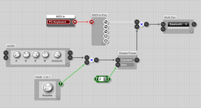

Im added A knob for mod env to oscilator. Basicly the knob is set to -1 to +1. So the signal from mod env goes to pitch of oscilator. Like on v-station. The only problem is when i pitch deep the sound get some clicking effect at the end how can i fix this any ideas?

If your trying for +/- 1 octave multiply your signal by your knob set your knob to -1 to 1 connect to power and use base 2 that way your knob at -1 multiplies by 0.5 = 1 octave down and at 1 multiplies by 2 = 1 octave up.

Sry but i dont understand mybe show an image or anything. Sry i dont understand so good.

Easier to show than describe
ENV Pitch.png (76.91 KiB) Viewed 17925 times

Ah nice mate but what do the stream power module do? AH like fixing the pitch?

the exponent function is a power I think,
so because frequencies rise exponentially,
the envelope value will too.
so before the exponent, the value looks like this as it rises->
1,2,3,4,5...
and after
1,2,4,8,16...

Its just a way of centralising the knob, you could just replace with a knob that go's from 0.5 to 2 but the no change ie multiply by 1 would not be in the center and if you wanted more octaves the effect would be more pronounced.
Try it and see use the power and set your knob to -2 to 2 = 2 octaves up / down then use a knob without the power that go's from0.25 to 4.

ok. But i need the effect when knob goes -1 to +1 like on v-station. Is this the same thing? I will try it now.

Anyway this dident do the effect i wanted :/
