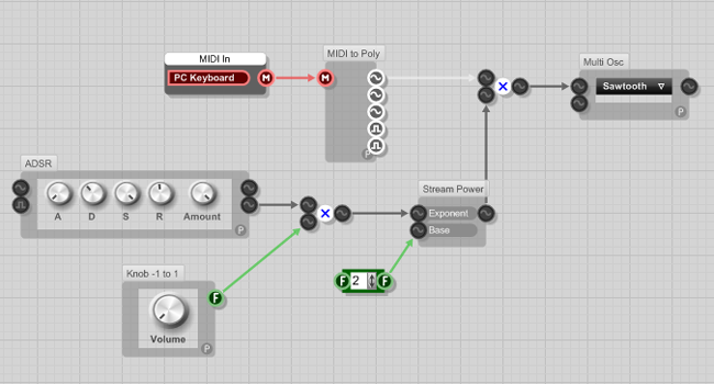

Easier to show than describe
ENV Pitch.png (76.91 KiB) Viewed 17917 times

Ah nice mate but what do the stream power module do? AH like fixing the pitch?
nix
Posts: 817
Re: Need some help mod env depth to osc?
Post by nix »
the exponent function is a power I think,
so because frequencies rise exponentially,
the envelope value will too.
so before the exponent, the value looks like this as it rises->
1,2,3,4,5...
and after
1,2,4,8,16...

Its just a way of centralising the knob, you could just replace with a knob that go's from 0.5 to 2 but the no change ie multiply by 1 would not be in the center and if you wanted more octaves the effect would be more pronounced.
Try it and see use the power and set your knob to -2 to 2 = 2 octaves up / down then use a knob without the power that go's from0.25 to 4.
