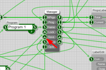

by Nubeat7
billv wrote:Why....?????
When using VST , the user can just save into a Preset Manager slot.
wouldnt it be enough to just trigger the save input of the pm primitive?
just installed greenshot to make screenshots and easily put arrows and stuff on it :lol:
Re: Preset Manager_Auto save/load.
Posted: Mon Feb 10, 2014 11:26 pm
by billv
No...that works in FS....but in VST/Standalone mode....nothing is there on plug-in reload.
Its always been like that :( . Very fustrating that the VST/standalone user can't use the
Preset manager just like we do in FS-save straight into slot..and it's there...
This VST/Standalone preset issue has led people(like me) to make "alternate" preset systems,
and you can see this in the last X11 Update, it's a very messy/ugly way to go about it. :lol:
I guess the file dialogs could be included, and bring back the option to save/load manually.
I'm still worried about the speed of it. And can only see 3 options to fix....
1. Stick all presets on 1 array and just load the one file on startup
2. Wrapping it all up into that dll componant thing might be possible....but I don't know C....
3. DSPR make a New Preset manager with option for autosaving.. :mrgreen:
