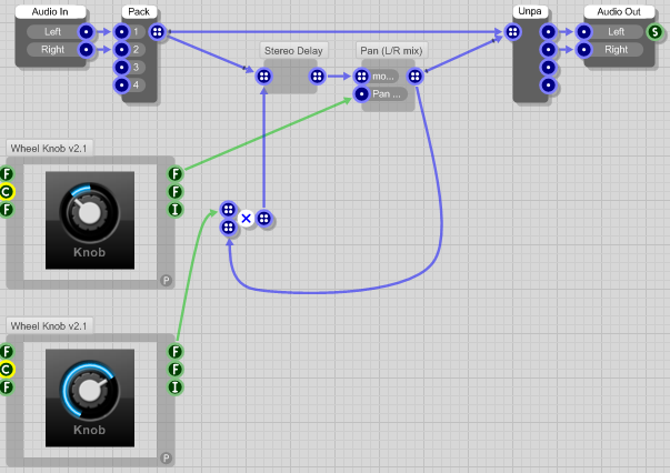

My current project has a feedback/delay loop with a L/R pan control inside the loop. As you'd expect, a non-neutral pan value causes the feedback signal to progressively travel to the left or right. I decided I wanted to add a switchable "ping pong" option such that the feedback signal bounces between the left and right. I can easily swap the left and right signals per cycle, which is the basic concept of the ping pong, but the problem that arises is that the pan function always pans in the same direction. Desired operation would be if the direction of the pan swapped along with the left and right signals. I'm not sure of a reasonable way to achieve that.
Here's a simple diagram showing the basic setup. It's just a feedback delay with a pan module. It carries a stereo (mono4) signal.
Feedback Pan.PNG (53.65 KiB) Viewed 18957 times
Is there a reasonable way I can make this ping pong without re-writing the delay and pan modules into a convoluted mess?

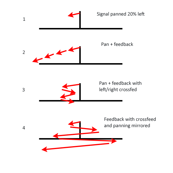

Refer to the diagram I posted above then check this out. This is what happens.
1 & 2 are desired operations. 3 is what happens if I just crossfeed the signals (as per typical ping pong) with the pan function inside the loop (the signals are flipped but the pan is always the same direction). 4 is what I want to achieve with the ping pong (the pan is flipped along with the left/right signals, progressively panning towards the outside like number 2).

4. looks like a pingpong with mono in ...
still dont get what you want, maybe a lfo to control your panner? i think it would be easier if you post the schematic and explain the issue inside your schematic, i also think it would be easier to understand when you take 2 singledelays (1 for each channel) its easier to follow the signal and when everything works as it should be you can pack it to mono4
