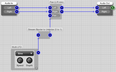

I just want simple lfo control the pan. How do i make this. Connect the lfo to pan. i added combiner but not working. The synth is in mono and out stereo.

You connect the output of the LFO to the input of the pan.

Ok can you show me how it looks in The pan pr mix module :) ?

hey Johan,
man u can do this IMO.
Pleases try and do it yourself if you want to get your head around SM 8D.
Set up a knob that has value 0-1,
that can be for left volume.
Then subtract 1 from this, and multiply it by -1.
That is the value for right.
Do all of this in green float maths,
you can easily see what the values are doing with a float readout.
I don't mean to be a prick, and that is not the essence of what I'm saying,
my patience is not wearing thin.
SM is a great playground for experimentation-
in that u don't fry anything-
so try and solve something kinda easy like this if you want,
coz I see you really like it- u can get better-
and this a great little device to work on.
That's a basic pan,
the best solution I have got for a 'pan law' is .75 volume on each channel when centred.
The basic one is .5, so when panned hard- the channel is twice as loud as centre.
All success bro 8D
oh yeah- just multiply the stream by the left and right number,
left for left stream and right for right stream.
To change level, use a multiply
