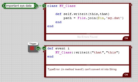

Since i went into the challenge of trying to deal with ruby i run into several problems here and there.
Most have to do with real understanding of all that object relating stuff and doing the right things at the right place concerning this matter.
Anyway...i'd like to do something like that:
Whatever i tried so far (and it was a lot) i always get that nil error. AFAIK the prob is that the input doesn't get through to the class method? What do i have to do? I guess it's a simple question but i don't get it... :roll:

Nevermind... i got it. Must have done something wrong before but now it works with class variables. Constant works as well...

This may not be a problem with the paste-Order
Defining a Class in a Rubyedit is OK - But getting data from the rubyEdit with the classdefinition is not OK and not that easy ... OK ...
Some smart guy told me some time ago "in ruby everything is an Object" :D (THX trogluddite) - well and if you think about that and combine this with global variables ($varname) then you have some power to get it working ;)

Yes, that's how i did it. Thanks for your help. And as i mentioned it also works with class variables and constants. It doesn't necessarily have to ba a global var.

Maybe you could post a short example?
I know that i do not have the best solution :D - but maybe we could find a better :D

like this...
