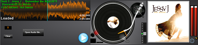

I wanted 2 make some modifications to mwvdlee's Skratz project and upload it as a christmas gift - well shit happens
before i even try 2 upload my messy schematic here a little desciption:
(if u don't know that project search 4 it in the SM Forum - its worth it)
I like it a lot and if u look a little closer inside it u see that mwvdlee put a lot of effort into that thing!
So my effort was to implement these features: ( btw. many of them already on his todo list)
1. Open nearly every lossy or lossless Audio file format (even CDA - this one works already)
b) read all tags too
2. automatically download missing Cover => works nearly perfect now
3. let it look and behave like a 'real' turntable (nearly done)
4. Automute => O.K.
5. auto rewind => =O.K.
ASO...
But part 1 isn't that easy like i thought...
mwvdlee already tried it right with 'Atomic Writes' means:
write it in a .tmp file then move it to the right destination for further use
I dunno if the TThreads are the crashers or my added ruby file and string handling modules...
Even if i only loaded a WAV after conversion and only have DS out active (not playing anything and CPU use shows 1%)
when i switch to another simple schematic even w/o external or ruby etc. it crashes immediately...
So after all that babbling: Do u guys also have much more crashes in the newest version?

- Skratz sun mod x640.png (116.21 KiB) Viewed 18140 times
