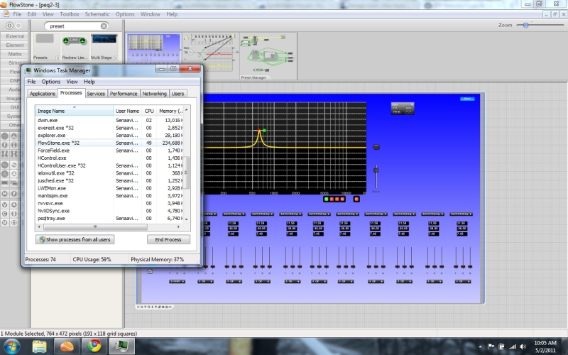

Hi,
1. I have problem with CPU usage in my project,
why the CPU usage is so high even without play around with it?
do you have any suggestion? please see the attached below
2. do I need to put "before preset change" and "after preset change" in every components?
please see the attachment project samples.

Use the redraw area primitive and only one for the area is needed. Also make the redraw area small as possible and keep it on default zoom. It's a very big area to redraw and the solution is not to zoom out, but make the area smaller instead.

1. Thanks for your suggestion, is this flowstone limitation? I have tried this project in flowstone v1.1.1 and v1.1.2, it seems the sluggish is not terrible as in v1.1.3, correct me if I am wrong.

1. I have v1.1.3. to work fine. Press CTRL + Shift + Alt + T and be sure the new trigger system is activated.
2. A image will only cause high cpu use if you're redrawing a big image very fast. Memory use would be the same as the size of the image.

Maybe I'm being a bit dim here, but I can see what your project actually does?
You seem to have two banks of EQ's but only acting on Floats (Green = slow)? If it's audio ( I see you have 20hz - 20Khz) you want to process then you need to be using Real-Time (Blue) connections!
Also you have some buses that get extracted and switched then re-combined, I would just use a sector to switch the whole actual bus.

Hi Morph and DSP,
Thanks a lot for all your suggestions,
It seems that there is improvement on it,
sorry to make you confuse about this project. basically this is not intentionally to control sound for PC sound card or internal DSP but for external device purposes. I am still studying how to communicate with external world (you can see from my other post). If I created in C++ or Java, yes I could do it but the problem I need to buy the license and I think flowstone is worth for it. So I want to try how good and what is the limitation from flowstone. As your information. currently this is only the skin and it is not final yet (5% only)
