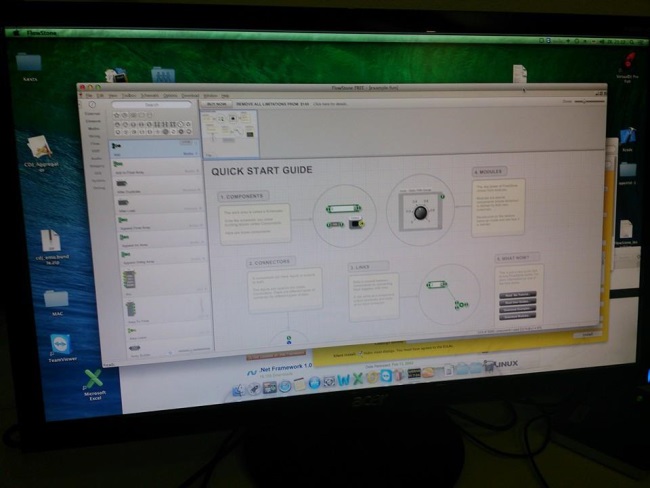

Well this is on of those Topics that might be hated by mac-haters.
Well i'm a 'little' hater too but there are users there outside that are let me say 'only able to work on mac'
So this Pic will get you up - and NO - this is no fake!!!
This is FlowStone Free runing on an OSX 10.8.5 powered with Winebottler:
(App gets arround 700mb :P)
Well - I have to say - it run for eaven 10 seconds before it crashed ^^

Well got some news:
Winetricks Settings: (check all those elements listed here)
cmd
dinput
directmusic

Issiues:
Startup error - but "normal" environment for FlowStone
Bitmaps are everytime NIL or NULL - they are not loaded correct - some dll is missig here tht i could not find
Audio is verry laggy with clicking noises
Wine is not starting a virtualWindows - it is emulating an Environment - so the FlowStone.app will get about 660 Mbyte when the built is finished.... I know i may have loaded to much now - i just wanted to check it.
Any more Ideas here?

Well i tested it now and it seems to work for some simple operations.
The joke:
If you load a file with the filedialog (coming from Winebottler - so the Dialog is like on mac) - You'll see parts your mac System. so some path Parameters E.G Documents or Desctop bekome mac equivalent and will take the Folders of mac. The mac System Folder is not accessable.
Belonging Ruby - when i integrated the VC2008 packs ruby was runing normal.
Only Problem at the Moment: No Bitmaps - None!!! - Not loadable.
Ther is some lib that FlowStone is using from Windows that i did not find and i hope some head here knows something about that.
EDIT Just noticed that the common dialogs are not updating the string. I make some tests tomorow.
