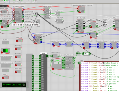

bad Loop causes massive ruby shutdown
billv
Posts: 1165
Location: Australia
Post by billv »
I've never seen 'a ruby companant shutdown' happen this bad.... :lol:
While inside main fsm, i added a bad loop...
about 80% of all ruby componants in entire fsm were turned off for excessive processing.
Thought I'd mention it in case there were more noobs out there playing with loops..
Practice loops in isolation.... ;)

trogluddite wrote:going through all of the modules to reset them is really time-consuming.
they were all frozen...couldn't re-open...
brought in new ruby module and tried to capture offending code for reference...froze as well..
I think maybe if i removed all module links..may have unfozen it...
but didn't try...schematic too big...just bailed out...
should have saved it under alt name to re-investigate.... :roll: ...bummer
