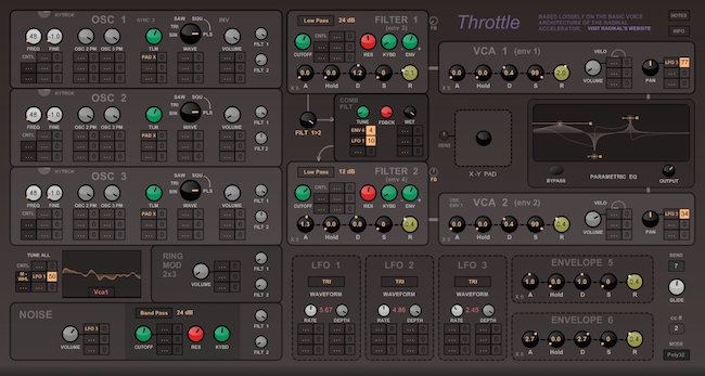

Back to the subject of the original post. I was so looking forward to including the Karplus in my emulation of the Radikal Accelerator, but ran into a complete brick wall when trying to complete this very old SM project with FS. It opens fine, and can work on it to some degree, but if I copy and paste anything, the program freezes; if I drag anything in from the toolbox, same thing. I finally gave up and am finishing it out with SM. Anyone care to try and see what may be the issue with this? Is it possible it's specific to my computer and/or install? Every other old SM project I've opened so far with FS has been no problem!
https://ln.sync.com/dl/f87583110/fkhzep ... g-ep7uyedb
Here's what this is looking like; almost done, but would love to include the Karplus.

The color scheme of the knobs is based on the slider colors on the Yamaha CS80; like tula, I have an aversion to over-flashy GUIs, but the Accelerator itself has the most boring-looking panel I've seen on a hardware synth! I sure wasn't gonna emulate that!
