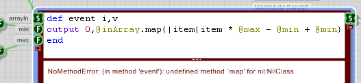

Thanks nubeat7....but i keep getting method error for map!...
changing code from '@inArray.map!' ...to. '@arrayIn.map!' didn't work also...
Writing the min max part will be ok, the problem is that the min/max parameters
are tied to the graphics, so it becomes a lot more complicated....
Probably scrap the idea.......

you don`t need event..
and sure, dont send the modified values to the graphics just send them towhere you need them

Nubeat7 wrote:you don`t need event..
Yeh..it goes...i figure the error was using string array input instead of float array?
...controlling min/max either side of draw module is not a issue for this circuit....
Need to control the draw module min/max parameters directly...
I don't think this mod can happen otherwise ...
