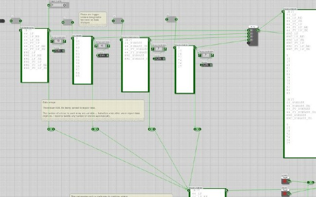

I very much need advice on a very fundamental aspect to most projects I'll be working on.
I've put together an example schematic that outlines a common scenario, and am hoping to get some guidance to get a design that works best.
In my example, I stayed with FS primitives ... I'm certainly not opposed to using some RUBY ... but, I'm still novice with FS ... let alone RUBY :lol:
I've try to comment section of the schematic, as I have presented 2 concepts that I've tried to use. The 2 are NOT compatible [in present state] with each other. Each has +'s & -'s to the way they work.
What I hope for is a system that I can implement that handles whatever number of arrays that I may need for a project. The 'size' of these arrays could also vary ... in fact, I have situation where a User loads in an XML file that I'm parsing [as configuration data] ... I won't know the number of entries, so I need to have flexibility.
I'm saving this data to the MY DOCUMENTS folder, and then auto-loading it back in to separated arrays that can then distribute this data throughout the schematic [I've included a typical pull-down menu that I'm feeding with this data.
I could really use some advice and guidance to, once and for all, get this core function resolved in a clean, solid way.

Save-Load multi-sized arrays [test] - 1.fsm
(12.91 KiB) Downloaded 1168 times

I have finally been able to reproduce the issue my bud was having ... this is a step forward.
I'm thinking my text arrays are just to bland :o
When the file gets reloaded, the number of entries for each of the arrays [using the SPLIT prim], can easily reset to ZERO [because the original XML file was not loaded to establish the variable]. This makes sense, and is really a bad way for me to program this logic. Must fix.
I'm wondering if including some type of HEADER in the config file that would contain each of the array sizes could be used to set all the other array Splits ???
just stinkin' out loud :?
