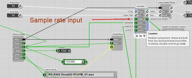

I was tinkering with this sampler which would be perfect if I could make it follow and match the tempo.
viewtopic.php?f=2&t=16256&p=51168&hilit=sampler#p51168
Should be possible as the counter has a sample rate input , just not sure how to do it or calculate.
I can get the BPM of the loaded wave , i got that much.
Just not sure how I can calculate the difference.
Lets say there is the DAW sample rate , say 44100 . and I load a 80 bpm Loop , how can I calculate the sample rate increase it needs to play at 120 ?
Or a simpler example perhaps , Lets say daw is at 44100 . 120 BPM , I load a 120 bpm Loop and I want to increase to 121 bpm , how much of an increase is that in sample rate ?
Maybe I am brainfarting at this point but I feel like if i could calculate that I might get this to work.
Feeling pretty stupid right now , lol

I am thinking if I could use this to pitch/stretch the sample according to bpm.
From the sampler in the earlier post.
sample rate.jpg (120.75 KiB) Viewed 17653 times

There is a very simple time-stretch/pitch-shift algorithm in my old SK1 sampler that you can find in this post which might be worth a look. The timestretch player consists of just two modules inside the "-> Player -> Stretch Player" module of the schematic.
It doesn't save or load samples, as it's designed to capture mono samples in real-time from an audio input, but its sample input is just a regular mem link, so it should be adaptable for loaded samples quite easily. Pitch and playback speed are independent of each other, where a setting of one is the original pitch or playback speed - dividing the desired BPM by the original BPM should give you the correct value for the playback speed. The 'window' setting determines the size of 'grains' that the sample is effectively chopped into; shorter tends to work better for percussive sounds, and longer for pitched sounds; but in any case, the quality of stretching is very basic, as ideally the grain size should be matched to the incoming pitch.
