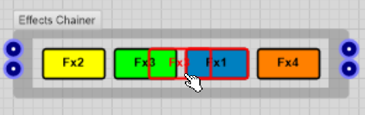

for shure you all know how to reordering your signalflow using busses, it is pretty handy but the audiodropouts and the work to avoid audiocrackles because of recompiling is really annoying, so i thought it would be great to havea solution in DSPcode/asm to reorder your fx on the fly without any audio dropouts...
for the ruby selector i used some technics from trogs cell array - thanks for that!

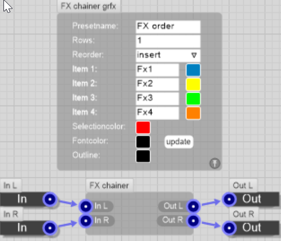

did a few changes, ruby code was a bit buggy, i added a preset part so the fx order can be save in presets now, and you can custumize the graphic easier and better now.. updated file in the first post

you also could use just the streampart of this one in trogs fx chainer, just delete all the audio parts in trogs chainer and place this one instead, so you can use trogs grafx part which is really neat with the transparent moving selection window while dragging...
but the benefit of this one is that you can place teh slots in different ways using the rows, or if you want to place each area individual you could change the createArrays methode to something like this:
and the ordering will still work..

finally, i added a ghost slot which appears when dragging a slot from one position to another.
i also implemented a second option how the position changing is done, you can choose between "swap positions" and "insert at position" in the swapOrder methode
