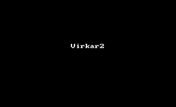

I tweaked this dropdown from maestro Tulamide, initially ifI moved out of the dropdown area it would just stay there so now it closes on mouseover leaving area , in case you decide to select nothing. Perfect as such .
The dropdown opens if I am above a dot and right click.
But I still have this problem when editing dots that are close together as it does not close/redraw the dropdown, as I dont manage to move out of the mouse area.
Wondering if I can pull some trick to make it close/redraw on a second right click if drpdwn is still open.
Tried a few things but nothing that worked so far.

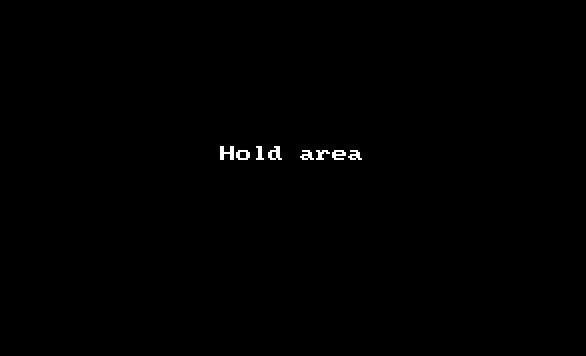

Also, a lesser issue but something I would like to understand.
When the dropdown goes over the area where the position indicator travels it hols onto this little chunk of the drpdwn menu . Does not do it if the pos indicator is not running.

Still have that lingering chunk though

Best guess: the drop-down has a 'Redraw Area' which is narrower than the drop-down module's MGUI and/or the GUI elements drawn there.
'Redraw Area' is best thought of as a hint to the graphics engine. You're making a promise; "I didn't draw anything outside here (so you can keep all the other pixels on the screen just as they are now.)"
But really, everything you draw is still constructed. Even stuff outside the redraw area is still there somewhere in an internal graphics buffer; you just don't see it because those pixels didn't have their new colours sent to the graphics card (in return for a nice efficiency saving, of course!)
But if something else comes along which does ask for that part of the screen to be updated (e.g. your indicator), the 'missing' pixels finally get sent from the internal buffer to the screen, and the 'hidden' drawing is revealed (but again, only in the bit which gets updated - hence the 'lump' is the same size as the indicator.)
When your drop-down is closed, the same happens; the 'lump' hangs around because the drop-down's redraw area doesn't ask for that part of the background to be refreshed - but again, the indicator does.
So have a look at the width and height of the module GUI, graphic elements, and the redraw area to make sure that your GUI is keeping the "I didn't draw outside here" promise. As a last resort, you could use a 'Clip' primitive, which really does cut a chunk out of whatever view you give it, but that's usually only necessary where constraining the drawing isn't possible any other way.

"Best guess: the drop-down has a 'Redraw Area' which is narrower than the drop-down module's MGUI and/or the GUI elements drawn there"
Indeed ! Thanks again Trog :)
Fixed
