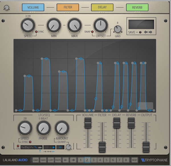

Here is the current version of the plugin, mostly finished except for the Shifting issue .
GIF.
https://imgur.com/xYAgCnP

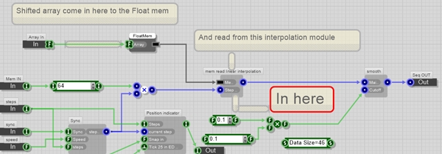

by lalalandsynth
This is where the shifted array comes in via the Shift array prim.
Shifted array.jpg (101.74 KiB) Viewed 17716 times
And goes into the Mem read interpolator module.
mem read.jpg (129.55 KiB) Viewed 17716 times
Now I if could find a way to shift it here with blue?
Thoughts ?
