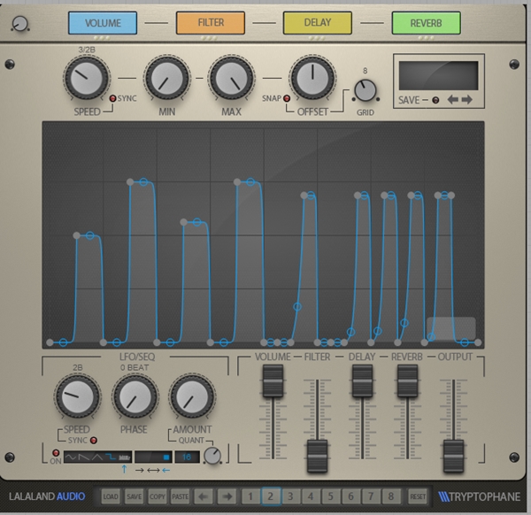

Here is the current version of the plugin, mostly finished except for the Shifting issue .
GIF.
https://imgur.com/xYAgCnP

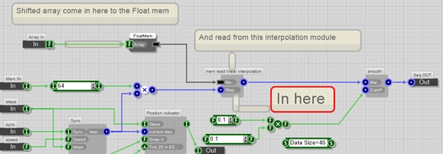

lalalandsynth
Posts: 600
Re: Sample accurate Array shifting.
Post by lalalandsynth »
This is where the shifted array comes in via the Shift array prim.
Shifted array.jpg (101.74 KiB) Viewed 17694 times
And goes into the Mem read interpolator module.
mem read.jpg (129.55 KiB) Viewed 17694 times
Now I if could find a way to shift it here with blue?
Thoughts ?
Btw, I would be more then willing to pay for someones time to make it so that I can shift the array with blue.
I have 2 plugins dead in the water if I cannot solve this and I think its more then worth it to me :)
