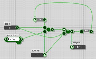

to use my code
you could replace your flip flop with this.
green flip flop with reset state
