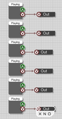

Myco pointed out before that If i use multiple ruby outs, FS would be faster on one link.
So if i have all the outs on one output like this...is FS still faster?...
I presuming that "parse" means loosly to "push the data"...
So what happens here on this link....any delay for parsing???....
or do all receiving inputs get exactly the same signal.
I guess in a way I'm trying to "eliminate" trigger order........
Here's the original question...
Is it better off to take something like this...
And turn it into this....
So who's faster..Ruby or FS

Ok, here's a context...
There should be no delays with something like this...yes????
Re: Ruby Speed Question
Posted: Thu May 30, 2013 6:51 am
by billv
billv wrote:Ok, here's a context...
...I didn't explain the "context' at all did I....?
Idea with above picture is for splitting up the "bool to false' trigger from the stop/start.
My synth relies heavily on this "bool to false' trigger....
Won't help for standalone but could tighten this area up for VST....
