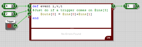

Hello!
I have a simple question to ruby but i did not find anything that was useable.
I want to execute some lines in ruby only if a Trigger in incoming like that:
ruby trigger question.png (15.66 KiB) Viewed 9674 times
i think it is simple - but i do not get it :D

Post by MyCo »
def event(i, v, t)
    output(@ins[0]+@ins[1]) if (i == 2)
end

Post by chackl »
Thanks it worked!!!
