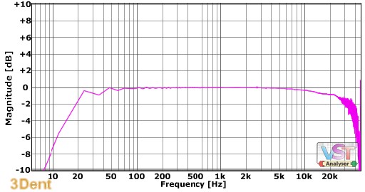

I'm finding a situation that I'd like to convert an image of a graph to a vector display to save space.
Here is an example of the typical image:
VSTAnalyzer [3Dent].jpg (33.52 KiB) Viewed 14864 times
[was a BMP ... had to convert to JPG to post.]
In vector form, I had thought I could alter the scaling [size] and still maintain clarity for display.
