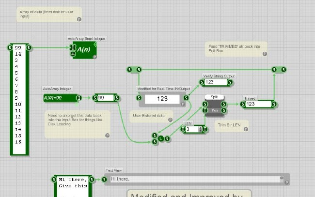

History ... I was fortunate to have 'TROG' make modifications/rewrite of a 'dual input' edit box routine. The initial 'design' needed a double mouse click to activate the edit box. The 'dual' inputs stem from data that can come in from disk that pre-loads the Edit Box. This box can also handle User input data. [this is a rather straightforward need in an app].
Now enter FS with RUBY.
Now I would like to find a better solution with FS {Ruby].
The 'design' idea has changed somewhat ... the double click to edit is something that I've reconsidered. It now seems just a single click would be more user friendly.
In the enclosed schematic I've included the TROG MOD'd [SM] version, along with my attemps in FS. Because this User data gets placed within the GUI of the app ... I need to apply restrictions to the entered data ... some are to maintain the GUI appearance, and others are to provide additional user friendlyness

Have recently made the transition form SM to FS. In the process, I've been able to improve my first project with the addition of RUBY's flexibility.
There is a MAJOR routine that I've been trying to convert that has me perplexed.

Re: INPUT Box [now to use RUBY]
Boy this is tricky ...
With a single click in the edit box, I'm able to edit the entry data ... but the 'text' is disappearing until I hit return
If I lift the returning feed line [that supplies the TRIM function], the editing display is fine. [but obviously the trimming is skipped].

Editboxes have that "disappearing text" issue since Flowstone I guess. I have similar problem (when editing - no text visible) with few other (somewhat looped) setups. It's issue of "edit control" primitive, that is used in editboxes. It worked correctly in Synthmaker.

This is the same module that I have posted in my first post.
By itself, clicking and entering data seems to work fine ... the text is visible the whole time. The problem shows up when looping back into the module ... text disappears until you hit [ENTER] or leave box.
But there are other issues with this ... at least with my minimal experience with RUBY.
It seems the design of this 'Edit Box' works on a different concept than I was expecting. There seems no true text variable in this RUBY code, or at least one that can be 'internally' controlled. I was looking at how to add 'string formatting' option [left, center, right], along with additional controls.

I also have a small pugin, that uses editbox over redrawed area (or it's because it is connected to flow of triggers?), and it behaves in the same way - in edit mode - text is editable but not visible.

i dont understand the issue here - the text is disapearing while editing when u feed it back into the edit box at the same time? seems to be logical that it disappears because it is a feedback loop it updates itself while you are edit it - isnt this the reason why there is an "is editing" bool at the output which you can use to break the feedbackloop while editing?
