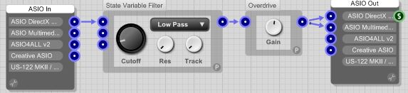

If you want to create a fuzz box, you can start here with this idea.
To do:
Add some type of EQ after the overdrive component
Experiment with the cutoff values and filter types.
Add a master volume control
Open the overdrive knob and change it's max from 1 to 1000. This is what will give you enough distortion, but just make sure you add a master volume control or get ready to blow your speakers...
Thats a Fuzz Box type distortion.
