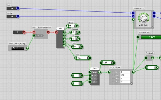

I can extract that part of the schematic, but it may be a bit to test it out as its 'input' is only MIDI data.
Secondly, as mentioned, it works fine when run from FS ... stops working as exported VST. Your mention of green 'motion' prims not working in DAWs is a bit troubling to read. :o
I've looked into using the DeZipper. It seems an M2F is the only prim I find to get back to a float. The problem there is that it needs an audio stream to function. Maybe that won't be such a problem in the end. I'm working on something new for me, and still learning.
Anyway ... this is a fairly simple schematic.
Data arrives at the MIDI IN port. There is a MIDI Channel filter to isolate a single channel. This is then 'split' off to have D2 as a value that will control a Knob connected to dual VCA's. Basically, MIDI data control audio output level. All else is eye candy info.
My goal is to do a form of 'damping' to changes in the data to ease dramatic level changes ... thus the idea to 'slide' into the new level. I'm also needing to address an issue when a MIDI patch change AND level change are sent. I need to figure a way to smooth audio levels during that time [audio cuts out during the patch change ... nothing I can do about that, so I need to work something out]. The problem has been when I export this, the 'Slide' no longer works, so any testing can't be done :roll:

Re: slide module - so how it works
Posted: Tue Jul 02, 2013 3:50 am
by MyCo
Try this
Don't know if this is addresses the problem you have, but there was a threading problem with Midi, that's why there was a de-threader module in SynthMaker. It isn't included in the FS Toolbox, may be it's not necessary anymore.

Posted: Tue Jul 02, 2013 4:29 am
by RJHollins
MyCo wrote:Try this
Once again ... MyCo, you have 'Saved The Day' ! :D :D :D
It WORKS ... even in the VST export ! Thank-you ! 8-)
Posted: Tue Jul 02, 2013 5:59 am
by MyCo
The Midi-problem is not a Bug... it's kind of a known misbehaviour. The background is: The Midi stuff runs in a separate thread (not the GUI Thread that the green trigger system uses). Here is the original description from Malc:
http://www.synthmaker.co.uk/forum/viewtopic.php?t=3673
