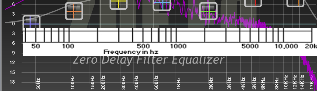

Ok, so Here's the ZDF EQ; It's pretty ideal for professional Audio Work. I wanted to show what flowstone can do because it gets flamed on KVR forums and perhaps it might improve outlooks a bit.
VST2 is still the only one in Ableton anyways.
Adding a few things; But this is a pre-final.
Attention: License changed to CCBY, refer to below post for details
Download: zdf eq version 26-8.fsm version 26.8 (303.51 KiB)

Looks like Hz markers are partly off a bit.

juha_tp wrote:Looks like Hz markers are partly off a bit.
Yes I designed this for 48000 sample rate; I'll make all of the other sample rates so that it matches up. I have other daws so I can test and implement for every sample rate affected. A lot of work; But I've been training to make the "real thing". I knew what I was getting into. This 44,100 I assume?
