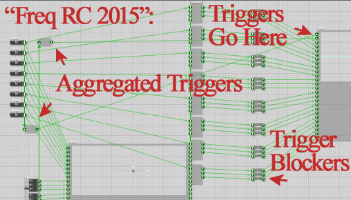

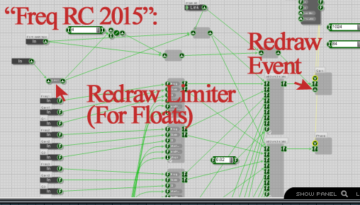

The first and second item are screenshots from the Open Source "Freq RC 2015" made by Nix

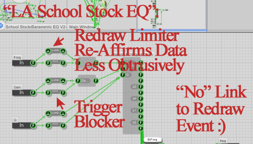

The third is a screenshot from My own EQ, The "LA Stock EQ"
Item #1:
Freq RC 2015-1
Freq RC 2015-1
genius - step 1.png (69.44 KiB) Viewed 20096 times
Item #2:
Freq RC 2015-2
Freq RC 2015-2
genius - step 2.png (69.24 KiB) Viewed 20096 times
Item #3:
LA Stock EQ
LA Stock EQ
genius - step 3.png (64.48 KiB) Viewed 20096 times
And now, on to how I made it sound like Waves audio: I added the Martin Vicanek De-zipper I found to all float values.
"I'll find a link"
But it was too smooth! :lol:

I’m all for promoting techniques that reduce trigger avalanches. With the system you describe you have to be careful that nothing in green happens when a plugin is not in view in a DAW. One example would be using a modulation wheel, which operates in the green world.
My comments were aimed at your continuing to promote the notion that green arrangements can have an effect on audio quality. For example, a de-zipper will NOT and CANNOT influence the sound quality when a control value is static. During a change of value the slightly uneven steps created by the asynchronous green system will be smoothed out by a de-zipper, and this eliminates the so-called “zipper noise”. If the de-zipper rate is set too high you might notice a lag in value change, such that a knob may seem less responsive. The default of 40mS is a perfect sweet point, which is why it’s the Prim’s default value. But once the set value is reached there is NO further interaction with the audio stream.
In addition, the mathematical processes in the green control world also have no effect whatsoever on the audio quality, whether you multiply or divide or do complex calculations. The exception is if you have a very high CPU use where you could get audio stream interruptions. These dropouts are clearly heard and would never be confused with effects on tone colour or any other aspect of sound quality or integrity. Of course, I agree for a computer multiplication is cheaper than division, but there is NO effect on audio quality.
The situation with mathematical processes in DSP is the same. The WHOLE schematic/VST is evaluated once per sample period for streams, and any calculations in DSP have to be made and completed in that time period. The only thing that can affect audio quality is the result of those calculations, irrespective of how the sample value is calculated. Tulamide has already pointed out digital “rounding errors” which are capable of accumulating when many calculations are sequential, but are totally inaudible in practice due to the masking effect in our auditory system, and would be swamped out by other non-linearites in the signal path, like minor DAC monotonicity imperfections.
