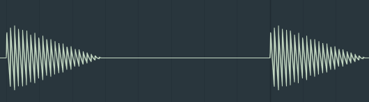

Perfect Human Interface wrote:I'm not seeing timing discrepancies with recording this thing into Edison so far
Ok. It's just not happening here at all. tested again for 3 min and stock vsti fails everytime after a while
At start
About 3 min
See what i mean?
My timer does not miss that black host mark. Stock vsti fails.

Upon closer inspection I can see that there are TINY differences in note start time, where the beat lines are drawn, and even where the "song jump" markers are placed in Edison (every bar). The notes mostly appear to start approximately 1 sample before the line (not exactly but very close). The "song jump" markers are within a fraction of a sample from the line. I don't see any drift after a 1 minute recording, more like "jitter" like Trog was suggesting.
Once again, these are tiny differences, one sample length or less. And thinking about it, it's not actually possible for a sequencer's timing to be absolutely "perfect" because sample rate and tempo are completely independent, so there's always going to be rounding, if I'm not mistaken.
It's also worth noting that since this synth is free-running, the appearance of the waveform itself is going to be different on every note, so that could very well effect what you're seeing trying to eyeball it in the playlist as well. If you used a recorded sample or a synth with no free-running qualities it would be consistent.
Now as for whether or not any of this makes the inversion test useless, I don't (necessarily) think so, because the ideal you're aiming for would be to match the host's timing since it's fair to assume you won't/can't do better. But the question here would be whether possible rounding differences that Trog suggested may surface, would could cause that test to fail even with a "close enough" to perfect timer. But about that I don't know.
**Okay I just now see the last post you made as I went to post this, and all I can say is that I'm looking at it in Edison, not in the playlist. Also your waveforms appear to be identical so I'm wondering why that is, since the stock synth's OSC's are free running, right?

Just did a 5 minute test and the notes at the end do appear to start slightly sooner compared to the lines drawn IN THE PLAYLIST. This does not hold true for the waveform and lines drawn inside Edison before dragging the recording to the playlist.
This may be an inaccuracy with the way the waveform is drawn in the playlist in FL. I would trust the view in Edison more since that's made for editing with down-to-the-sample accuracy while the playlist is just for sequencing music.

Perfect Human Interface wrote:worth noting that since this synth is free-running, the appearance of the waveform itself is going to be different on every note,
Uummmmm.....
Perfect Human Interface wrote:I don't (necessarily) think so, because the ideal you're aiming for would be to match the host's timing
Na mate, I'm there waiting on the money, at every host black marker.
Where's the Stock vsti and the host seq?...........Failed to qualify for the race.......
diqualified....that's where..
Perfect Human Interface wrote:stock synth's OSC's are free running, right
Yeh Trog has mentioned this "free running" thing before. I don't really get it, seeing the picture above.
