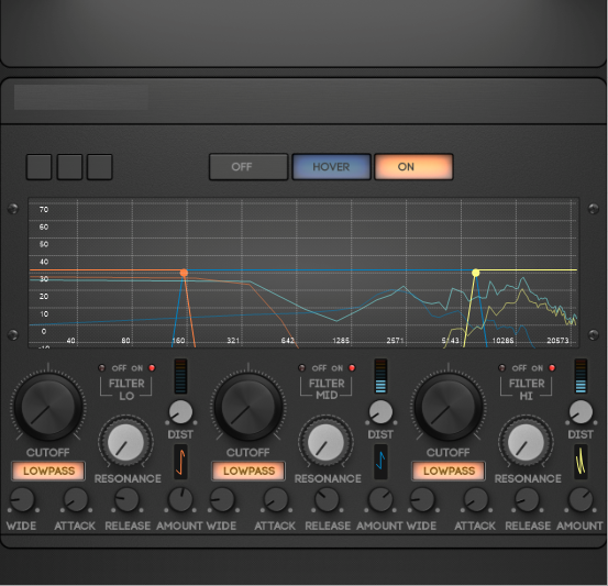

Is there a way to make a bitmap drowdown list , I find the default ugly.
I am referring to the popup that appears when dropdown list is engaged.
I would love to be able to customize it .
Searched the forum and my library but cannot find anything.

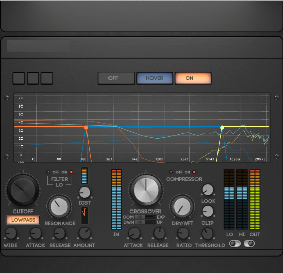

Indeed,Its a shame to do a fancy GUI and then have this windows dropdown.
I need this for the Filter selector window.
I wonder if someone here that is an expert at ruby would do this for a fee ?

It's actually not that difficult.
The basis is Flowstone's ability to move a view within another view. Just move the "menu" view out of sight, then when the user clicks to open the menu, move it to that coordinates. The code for the menu itself would be much like a listbox, so my Ruby listbox module might be a good starting point:
http://www.dsprobotics.com/support/viewtopic.php?f=3&t=3928
