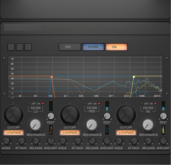

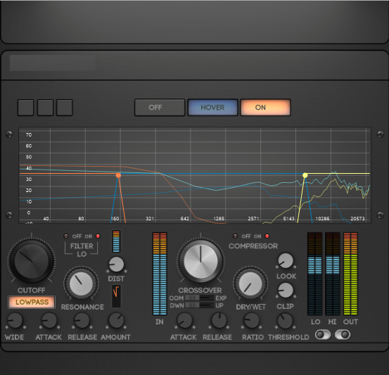

Is there a way to make a bitmap drowdown list , I find the default ugly.
I am referring to the popup that appears when dropdown list is engaged.
I would love to be able to customize it .

Indeed,Its a shame to do a fancy GUI and then have this windows dropdown.
I need this for the Filter selector window.
