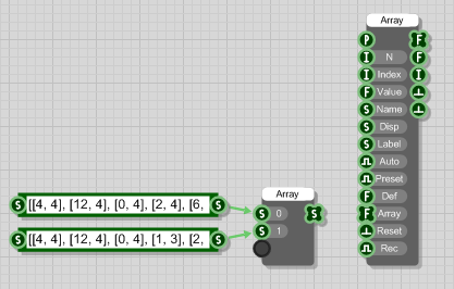

I hooked up a Preset manager to the "preset string" in the Arp. This is fine but I can't modulate
10 presets on the fly, via the tickers, as the preset manager is just to slow in re-calling the info.
So I've back to the other save+ load system, just like the one that handles the envelopes in the tickers.
Works great. But it dosn''t save on shutdown and re-load on startup. I think the user will really need this
feature when punching in thier own patterns.
But having said that, I've done some cowboy attempts with the preset manager.
One was using the same "preset string" setup in the arp, but 10 of them. Didn't work.
The most sensible way to me was to put all the strings into an array and throw it in to
a "VST Parameter array" module. But this dosn't work, cause it only takes "float array" input.
String array on the other side is just wrong, with no commas. And I don't feel like creating
the system to place every comma where needed.
Why cant we have a VST Parameter array" with string array input?
Is that what the "preset string" module is for......might have to try that method again......

You can do float array to string,
string to float array if u need it.
It's a bit fiddly but yeah.
I'll help mate,
if u post the schem,
I'm happy to do the conversion from string to float array.
The limitation of preset string module,
is it can only contain 2048 charachters IIRC

nix wrote:I'm happy to do the conversion from string to float array
These strings have got comas mate
Doing my head in at the moment. Don't think it's going to happen that way

Is it possible to have the string data without commas?
I think my sequencer works again Bill,
I can send the .fsm.
Timing seems quite good,
I will do extensive tests and see how many samples out it is,
but can just set 2 going and listen for phasing. It's good.
I am happy to produce tracks with that accuracy.
If the commas are neccesary,
yeah man, use preset string.
It will do it
wee edit-
since ur data is numerical, I'm sure we can figure out how to get it into a float array preset,
if neccessary
