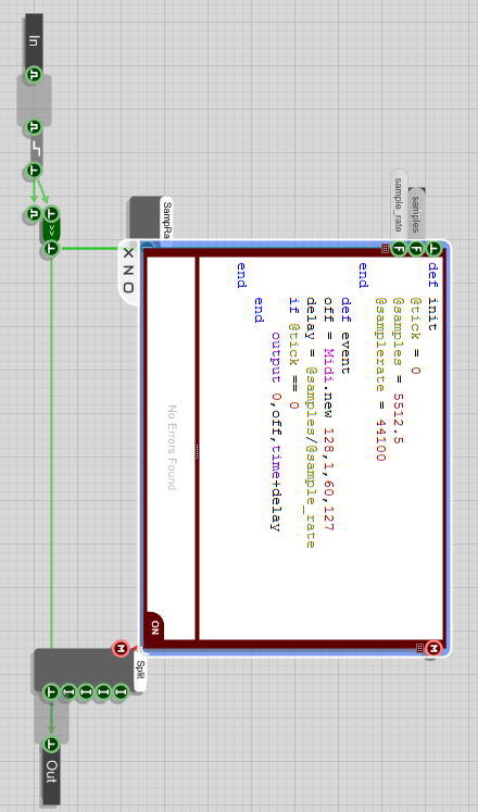

Since I have been so successful at crashing my DAW with Ruby,
I would like to post 2 examples that I need to be 'proof read'.
A MIDI ticker->
MIDItimer_test.fsm
(25.19 KiB) Downloaded 996 times
MIDI timer.png (37.6 KiB) Viewed 23268 times

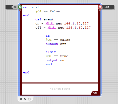

& a note on/off switch->
MIDI_OI_test.fsm
(8.16 KiB) Downloaded 976 times
If you'd like to tell me if these codes should be bug-free,
or what is wrong I would appreciate it.

In the midi timer @tick is alway zero, so you could remove everything related to it. I don't get what the rest of the schematic does. You generate a Midi event, but don't use it at all... weird.
The Midi-OI(?) code looks way to complicated for what it does... could be done much simpler, like this:
def event(i,v)
   output(Midi.new(v ? 144 : 128, 1, 60, 127))
end

The idea with the MIDI tick is ->
1.It's function is outputting a green tick with the soundest possible timing.
2.It uses the soundcard's clock, the Ruby MIDI syncs to it.
The timing has errors as it goes to green, but they are minimal.
It's usable
3. You can render this in a DAW, as the MIDI will be opened by the DAW.
If you use green triggers, generally they don't render.
I will try the fixes you suggest, much thanks!

I don't think it's your Ruby code as such that is making problems.
I think it's more likely that the feedback loop of the timer is unstable.
You essentially have a loop something like...
Ruby -> MIDI -> Green -> Ruby -> etc.
As Ruby and Green have completely different timing systems, and are probably on different CPU threads too, it's possible that the "circle of conversions" is what is causing the instability of the plugin - some sort of race condition going on that leads to triggers or Ruby events crashing into each other.
The kind of timer you want could be made much more simply by adapting the "Custom Ticker" from the toolbox - substitute your sample rate maths for the "step" input box, and then just use the green trigger that it puts out directly. The actual timing "loop" is then totally inside the Ruby primitive, so should be more accurate - the only change between different "clocks" would be at the green trigger output, with no green triggers going right around the loop and back into Ruby.
Using MIDI doesn't affect the timing, it's almost just an extension of Ruby in FS. The only requirement for sample accuracy is that you have some audio running somewhere - and once inside a VST export, you may not even need that, because all host<>plugin communication has to happen at that rate anyway (I'll be testing this soon with the PPQ thingy I'm working on).

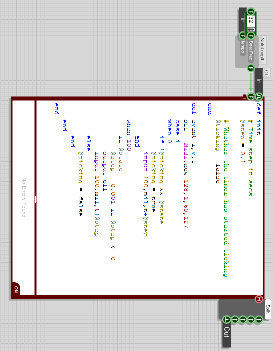

So I modded the custom ticker to send a MIDI note on/off instead of a tick.
I will pm you an example showing the audio discontinuities caused by other operations,
if the little MIDI mod isn't done Trogs. I confirmed it again.
But, {cry} it's equally crashy in Orion.
Here is the new MIDI timer->
MIDItimer_test_mkII.fsm
(11.2 KiB) Downloaded 1032 times
MIDI timerMKII.png (37.83 KiB) Viewed 23209 times
Does this code look alright also?
I'm pretty certain this is the single operation that is causing the crashes.
There is one instance of it in each schematic.

edit2- It didn't, i dunno what's wrong. Also, the Ruby ticks do stutter when using GUI in host. MIDI is neccessary I think at this point again.
Now I'll delete things again to stop the crashing-starting with Ruby
edit3-It's not an incompatability between FS,Orion & Ruby per se. Example synth works fine with multiple instances. It's something I'm doing here.
