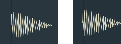

Houston...we have a problem... do you read.....
Created a ruby midi test synth, stripped back to nothing.
Ran it for 3min at 1/4.
First picture at the start, the other at about 3min.
Not the same.
here's the test synth.
Ruby test_0.fsm
(34.93 KiB) Downloaded 1194 times
Required next step- test for 10/20 min- verify that the drift keeps stretching...

Re: How to test the "Tick" without using sound??
Posted: Thu Apr 18, 2013 7:37 am
by billv
nix wrote:I don't think streams drift at all Bill.
Ok. I'm not sure the stream test concept is any point here at the moment, cause I'm back to
trying to land one note, on the money, and failing.
here's the latest one, same test synth, this time went to 5 min exact.
First picture at start, the second after 5min
it's not accurate.Full stop.
My designs have been proven now, in-accurate, more than 4 times , using 3 different systems.
Sorry mate, But I'm back in the land of 99.9999% blah blah blah.....
