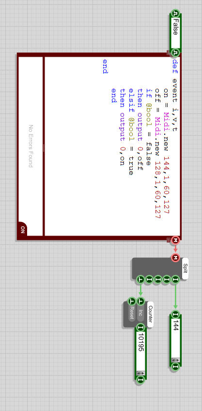

I got my hands just a little bit dirty with Ruby just now.
I was wondering if anyone could help me getting this to work->
I have re-upped the working one below
It's just a simple note on/off
All success
I got this to work.
Here it is->
MIDI_OI_Ruby.fsm
(431 Bytes) Downloaded 1123 times

nix wrote:hands just a little bit dirty with Ruby
Great to hear Nix. We can learn this Ruby beast together.
Maybe your next step could be to try output the counter tick from ruby at the same time,
so you can ditch the "Split" module. Create another output as well and output the 128/144 numbers as well.
Just a thought. :)

nix wrote:I got this to work.
I've been using it a lot.Works great.
Cheers mate.

Welcome 8D!
It gave me a little thrill when it started working,
using ==
instead of =
Re: Ruby MIDI note on/off?<solved>
