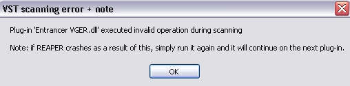

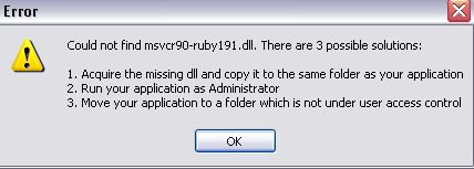

Here are the 2 errors from Reaper, Win XP 32 (SP3). Intel Core 2 Duo @ 3.16GHz, 4GB DDR2 memory
Entrancer bug report (regular version Reaper load error message).jpg (44.49 KiB) Viewed 29146 times
This version has no ruby components
Entrancer bug report (VGER version Reaper load error message).jpg (34.04 KiB) Viewed 29146 times
This version has an empty ruby codebox
What can I do?

Re: My synth is incompatible with XP SP3{cry}
Posted: Wed Feb 27, 2013 7:40 pm
by billv
nix wrote:to get the ruby .dll onto his system,
You mean the Ruby dll dosn't get installed when a user installs the plug-in??
Is that the current behaviour of FS? Can't be right. Still on FS Free, so I'm not sure.
If thats the way it is, you'll have to find a way to include it your installer, so it deploys
on the user's machine. A real pain.
Posted: Wed Feb 27, 2013 8:47 pm
by support
The ruby dll currently is wrapped up with the plugin dll and extracted to the App Data folder when the plugin is opened. We're trying to see if there is a better way of doing this but for now this is how it works so the dll should be present on the user's XP machine.
For XP the App Data folder is here:
C:\Documents And Settings\[user name]\Application Data
Check if the dll is present in that folder. If it is then it could well be the same issue that billv had with missing elements from XP, in which case there is a suggested solution there on the thread you linked to above that is worth trying.
Posted: Wed Feb 27, 2013 10:58 pm
by nix
OK-
We got it going.
It required the .dll in the C:\Documents And Settings\[user name]\Application Data
Probably security permissionms did not allow the plug to unpack it to there.
