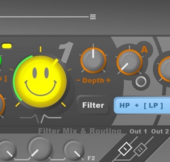

I'm adding a tiny filter curve visual to my synth. Not representative of the actual filter curve. But...
Kinda feels wrong using log10's for a very rough visual representation only. Even if it's only in green and run at half framerate.
Should I create a LUT array. I guess it would take some comparison, division, subtraction and multiplication.
Any point in LUT to replace 3 instances of log10 (1 used for the arc in the knob dial)... or just a big waste of time?
