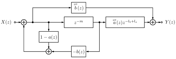

I'm lost with this scientific article. Someone could help ?
The article talk about another type of allpass.
I try to make one in flowstone but i don't understand what mean a(z)z^-lb+la in this image.
Any idea what it is ? delay, filter, multiplication ??
Thanks for any idea !
The article is : Frequency-Dependent Schroeder Allpass Filters by Sebastian J. Schlecht
https://www.mdpi.com/2076-3417/10/1/187

la and lb are the degrees of a(z) and b(z), respectively. In the examples given both are equal to two, so z^-lb+la = 1, you can ignore that factor in that case. (If you choose different degrees for a(z) and b(z), then you have to add an extra delay of (lb - la) samples.)
I played a bit with the frequency dependent Schroeder allpass filter as proposed in section 3 of the paper. It is indeed allpass, but it can get unstable very easily, so I am not sure it is a great help.

Thanks !! So an additional delay and maybe the first delay could also change.
I try some value but could only approach an allpass. Will try again.
